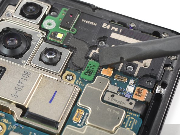

Samsung Galaxy S21 Ultra Laser AF module Replacement, Disconnect the laser AF module: crwdns2935265:00crwdnd2935265:01crwdnd2935265:02crwdne2935265:0 Samsung Galaxy S21 Ultra Laser AF module Replacement, Disconnect the laser AF module: crwdns2935265:00crwdnd2935265:02crwdnd2935265:02crwdne2935265:0
  • Use a spudger to disconnect the laser AF module cable by prying the connector straight up from its socket.
Usa uno spudger per scollegare il cavo del modulo AF laser sollevando il connettore direttamente dalla sua presa.
