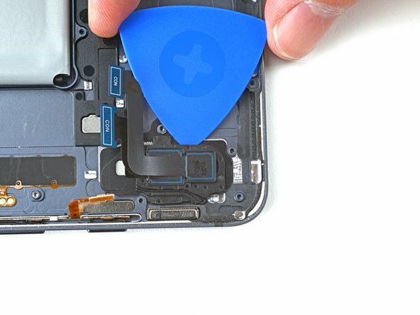

Separate the rear camera's adhesive
  • Insert an opening pick into a gap between the rear camera and the frame.
  • Rotate the pick around edges of the rear camera to slice the adhesive.
