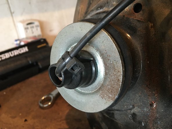

Zip Tie
  • A zip tie holds the cable to a plastic ring at the top of the shock, cut it
  • Remove the plastic ring / aligner and put it somewhere safe
