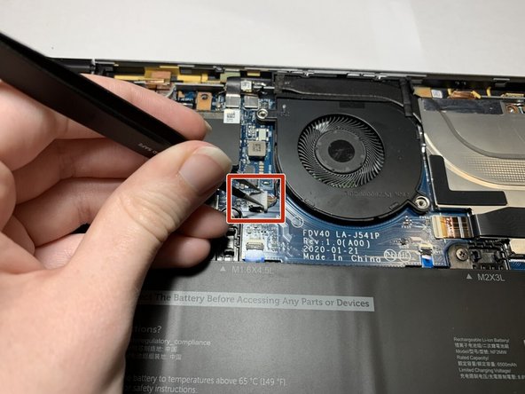

  • Grip both sides of the fan connector plug with tweezers, and pull directly backwards, toward the cables, until the plug disconnects.
