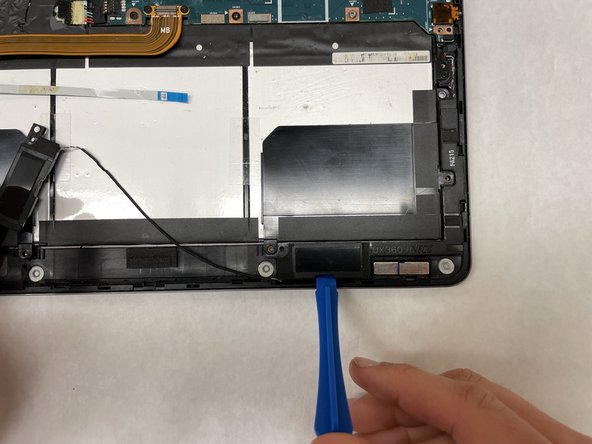

  • Use a nylon spudger or an opening tool to carefully pry the speaker from the chassis.
  • The speaker is held down with a mild adhesive. Work your way around the border to fully remove the speaker.
