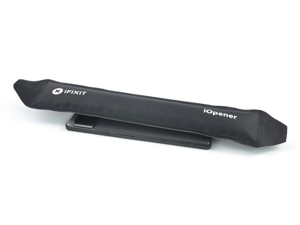

How to Disconnect the Battery in the Google Pixel 6, Loosen the graphite film adhesive: crwdns2935265:00crwdnd2935265:01crwdnd2935265:01crwdne2935265:0
  • Apply a heated iOpener or a heat gun to the rear glass to loosen the adhesive underneath the graphite films on top of the battery. Apply the iOpener for at least two minutes.
  • Don't apply heat directly onto the battery. It is susceptible to heat damage and could cause a thermal event.
