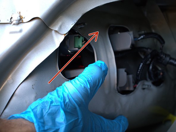

  • Push the tail light assembly out from the inside to unclip it.
  • Push the tail light assembly in the direction that the arrow faces. You may have to push firmly or slightly wiggle the assembly side to side, if it does not immediately come out.
  • Be careful not to cut yourself or any wires on any metal edges.
