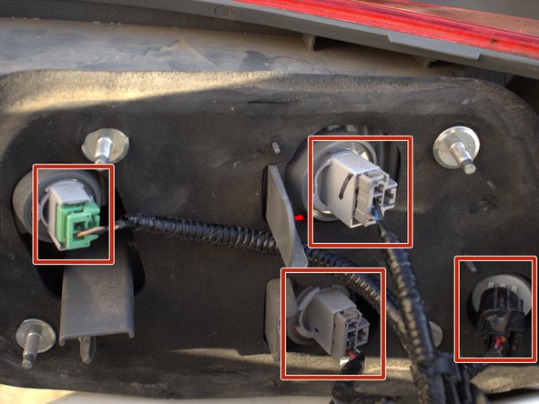

  • Remove each of the four connectors from the tail light assembly.
  • Do not worry about remembering the connection spots as each male connector has a unique shape corresponding to a female connector.
  • Do not pull hard on the wiring harness when disconnecting the connectors as it will damage the harness and potentially electrocute your hands.
