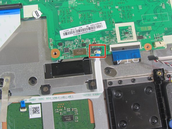

  • Using an iFixit opening tool, detach the track pad connector from the motherboard.
  • Potential for device damage: Be gentle while detaching the connector.
