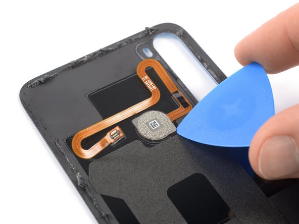

  • Slide an opening pick underneath the fingerprint reader.
  • Use the opening pick to slice the adhesive of the fingerprint reader and pry it up.
  • The fingerprint reader cable is held in place by mild adhesive.
  • Use the opening pick to carefully loosen the fingerprint reader cable adhesive.
