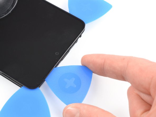

  • When you slice near the front facing camera, insert only the tip of the opening pick to avoid damaging or smearing the camera.
  • Insert a fifth opening pick and slide it along the top edge of the phone to slice the remaining adhesive.
  • Do not try to remove the display all the way yet, the display cable is still threaded through the frame.
