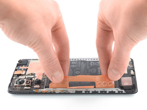

Lift the battery out of its recess
  • Pull up on the orange adhesive strip labeled with the A to lift the battery out of its recess and swing it up to an upright position.
  • Although these adhesive tabs are supposed to make the battery removal easier, they may require some force. In case you're having trouble removing the battery, you can apply a heated iOpener to the center of the display to loosen the adhesive underneath.
