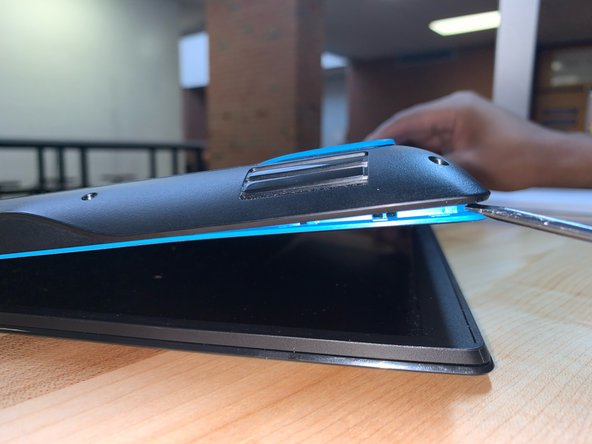

Pry the bottom plate open
  • Insert a flathead screwdriver or guitar pick in between the keyboard cover and bottom plate.
  • Carefully pry the keyboard cover and bottom plate apart until all the clips around the outer end unlatch.
  • Remove the bottom plate to reveal the internal parts of the computer.
