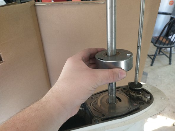

  • Remove the inner housing. The impeller should be stuck tightly inside the inner housing and will come off with it.
  • The impeller has a key that holds it to the shaft that will fall out, be careful not to lose it.
