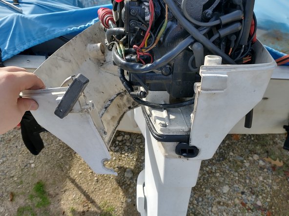

  • Trim the engine all the way up and pull the two halves away from the engine and downward, removing the rubber holders for the battery connection and control cables
