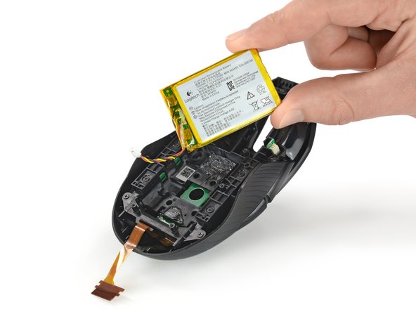

Logitech G903 Battery Replacement, Remove the battery: crwdns2935265:00crwdnd2935265:01crwdnd2935265:01crwdne2935265:0
Remove the battery
  • Remove the battery.
  • During reassembly:
  • Never install a deformed or damaged battery, as doing so is a potential safety hazard. Replace it with a new battery.
  • If the battery adhesive is still sticky, you can reuse it. Otherwise, remove all the old battery adhesive.
  • If your new battery has adhesive pre-installed, remove the plastic liner to expose the adhesive. Otherwise, apply strips of thin, double-sided tape to the battery well (not directly to the battery) where the old adhesive was.
  • Firmly press the battery into place, making sure the cables are near the rear of the case.
