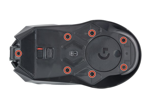

How to Open the Logitech G903, Remove the case screws: crwdns2935265:00crwdnd2935265:01crwdnd2935265:02crwdne2935265:0 How to Open the Logitech G903, Remove the case screws: crwdns2935265:00crwdnd2935265:02crwdnd2935265:02crwdne2935265:0
  • Use a Phillips screwdriver to remove the seven 4.5 mm screws securing the two halves of the mouse together.
  • On older models, the top middle screw may be a Torx T5.
