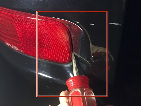

  • With the flat screwdriver remove the taillight housing.
  • Insert the flat screwdriver and slowly pull back to avoid damage the car paint.
  • Unplug the taillight housing.
