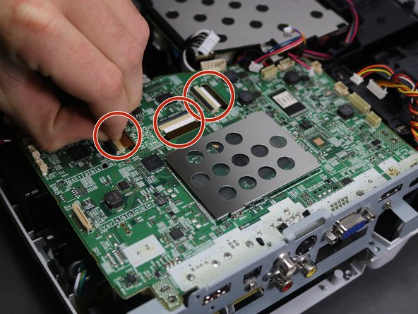

  • Using a spudger or your fingernails, lift up the black locking tabs and disconnect the three ribbon cables from the motherboard.
  • For more information on Zero Insertion Force (ZIF) connectors, please visit this guide.
  • Using the Phillips #1 screwdriver, remove three 10 mm screws on the grey piece that is located on the side of the motherboard.
