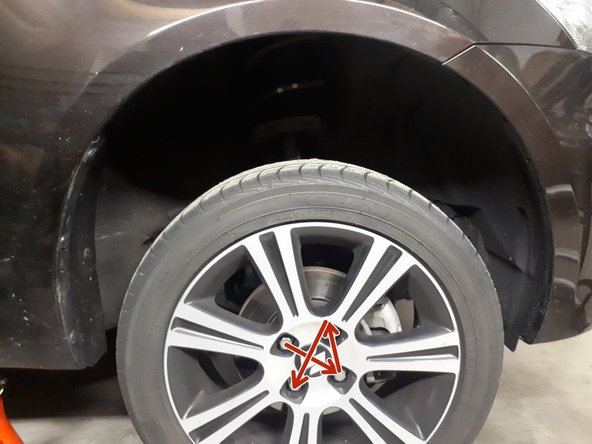

2010-2017 Suzuki Swift Front Springs Replacement, attach tire: crwdns2935265:00crwdnd2935265:01crwdnd2935265:01crwdne2935265:0
attach tire
  • Place the tire flat against the wheel hub and make sure the hub holes line up with the rim holes.
  • With the 17mm socket, screw the wheelnuts back in. Tighten to 85 N·m.
