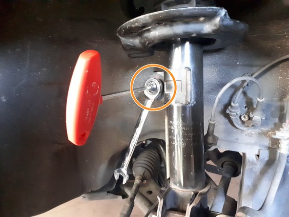

attach the rest
  • Connect the stabilizer bar link. Tighten to 50 N·m.
  • Bolt the brake cable bracket back on to the strut assembly. Tighten to 25 N·m.
  • Attach the sensor cable to the mounts on the strut assembly.
