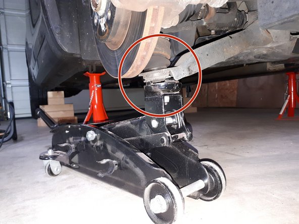

2010-2017 Suzuki Swift Front Springs Replacement, disconnect bottom strut assembly: crwdns2935265:00crwdnd2935265:01crwdnd2935265:03crwdne2935265:0 2010-2017 Suzuki Swift Front Springs Replacement, disconnect bottom strut assembly: crwdns2935265:00crwdnd2935265:02crwdnd2935265:03crwdne2935265:0 2010-2017 Suzuki Swift Front Springs Replacement, disconnect bottom strut assembly: crwdns2935265:00crwdnd2935265:03crwdnd2935265:03crwdne2935265:0
  • Put the jack under the wheel arm and let the jack bear the weight of the arm but not lift the arm.
  • Using the 17mm socket, unscrew the nuts from the strut bracket bolts.
  • Use the punch and hammer to punch out the bolts.
