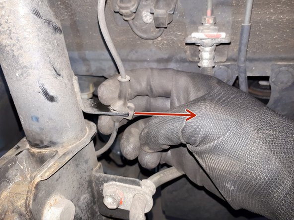

detach cables
  • Pull the top sensor attachment from the mount.
  • Use the 12mm to disconnect the brake cable bracket.
  • Unclip the lower sensor attachment from the mount. Use the plyers to compress the locking part and pull out the clip.
