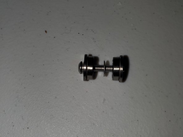

Left Corner
  • Take 1x M3x20mm screw. Slide 2 F623zz bearings with a M3 washer in the middle.
  • Push the bearings together and insert the washer bearing sandwich into the bearing tool and remove the M3 screw
  • Insert the bearing sandwich with the bearing tool into the Left Rear Corner assembly using a 1x M3x30mm socket head screw but do not tighten completely.
