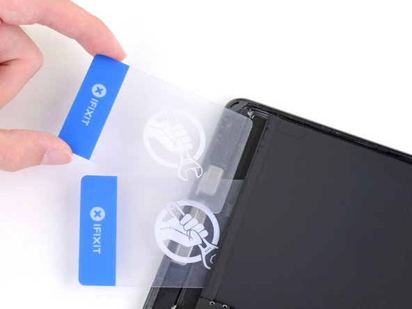

Insert a second plastic card
  • Insert a second plastic card between the battery and first card, this time with the card edge parallel to the battery.
  • Press the card in until about an inch and a half of it is underneath the battery.
