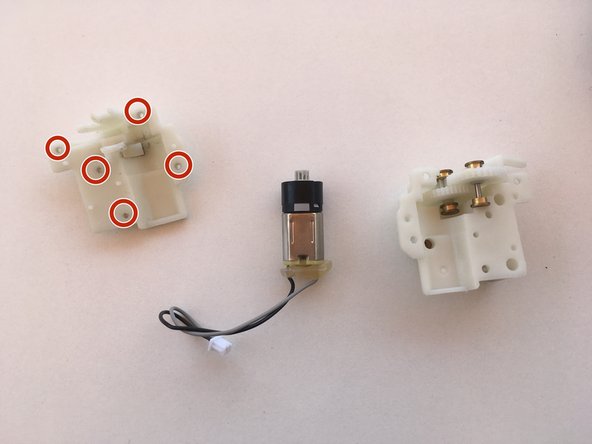

Disassembly the focus motor
  • You can disassembly the motor and give it a good lubrication (I had to do it, that is main the reason of this guide).
  • Sorry for not showing you the screws, I forgot to photograph them, but they are located here. Five in total.
