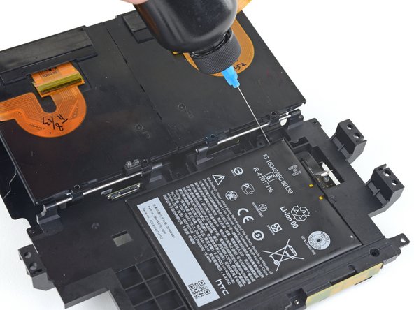

Remove the battery
  • Apply high concentration isopropyl alcohol (90% or greater) along the left side of the battery and allow it to soak into the battery well.
