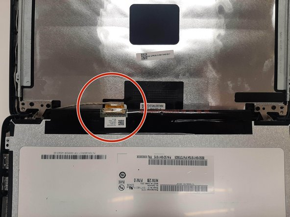

  • Peel back the tape holding the display cable connector in place.
  • Carefully pull backwards on the cable to disconnect it from the screen and lift the screen out of the laptop.
