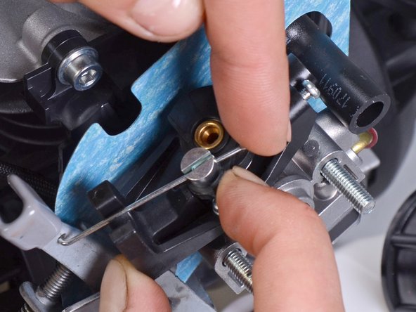

Remove the throttle linkage
  • While pulling down on the throttle pulley, use your finger to lift the throttle linkage out of its slot on the pulley.
