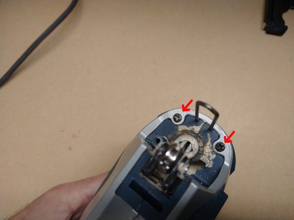

Remove metal cover and wire blade guard
  • Remove 2 Posidriv screws from front cover, then slide off front cover and remove wire blade guard, which rests in a recess behind the metal cover.
  • Remove one Torx T20 screw
