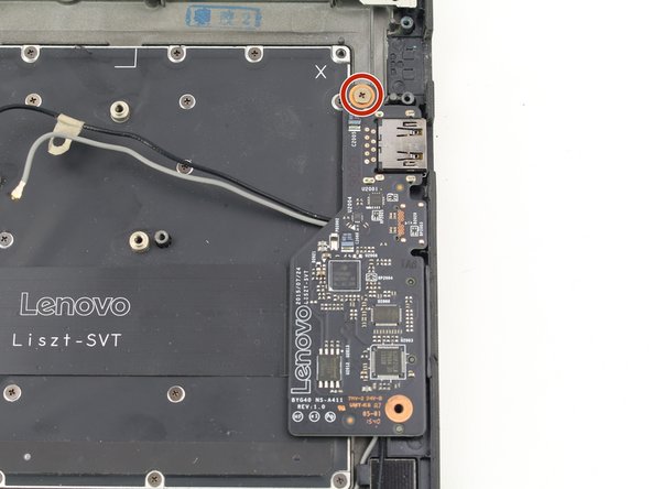

  • Remove the 3.6 mm screw from the daughterboard on the right with a Phillips #00 screwdriver.
