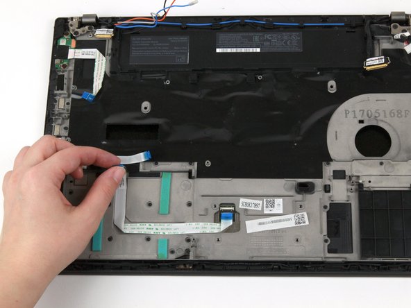

  • Peel up the white ribbon cable.
  • Potential for device damage: The cable may be attached to the laptop with strong adhesive, so be cautious not to tear it.
