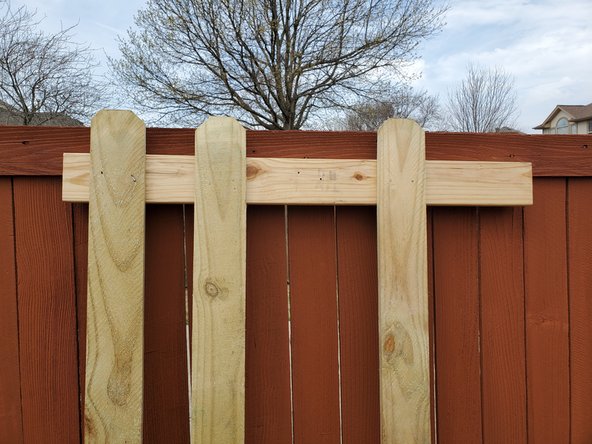

  • Before installing the new picket, clear the area of any debris.
  • Obstructions may cause the picket to be crooked when installing, or make a gap too large for the nails to work properly.
  • Use the tape measure to measure the gaps between the left and right side of the picket.
  • Doing this allows the replacement picket to be centered directly between the other pickets.
