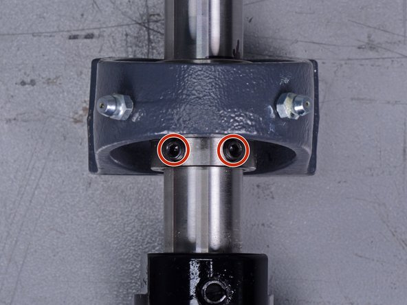

Remove the right arbor shaft bearing
  • Use a 1/8 inch hex key to loosen the two set screws on the arbor shaft bearing next to the blade backing plate.
  • During reassembly, do not tighten these set screws until the bearings have been secured to the frame to ensure proper alignment.
