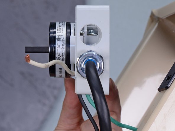

  • Use a 1-1/6 inch wrench or an adjustable wrench to loosen the wiring harness cable's strain relief fitting from the switch housing.
  • Once the fitting is loose enough to turn by hand, twist the wiring harness cable and fitting counterclockwise until it is fully unthreaded from the switch housing.
  • You may need to rotate the switch assembly itself since the wiring harness cable is connected to the device, preventing it from rotating freely.
