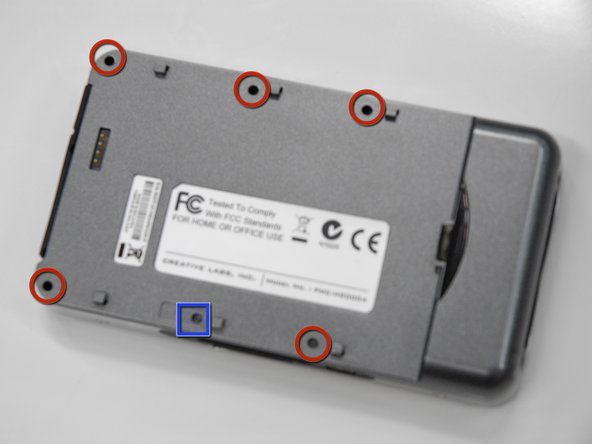

  • Remove the 5 screws (5.5 mm), circled in red, using a Phillips #0. Use a flashlight if necessary.
  • Peel off the sticker that says "Creative warranty void if broken" and remove the screw (5.5 mm) underneath with a Phillips #0.
  • Be careful, some of the screws are difficult to see and can be easily stripped.
