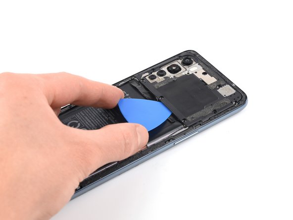

  • Insert the tip of an opening pick under the motherboard cover.
  • Use the opening pick to lift the motherboard cover up and release the plastic clips that holds the cover in its place.
  • Remove the motherboard cover.
