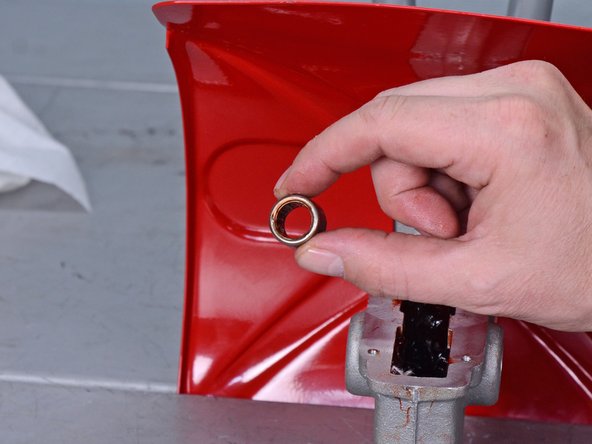

Separate the left-hand bearing assembly
  • Separate the tine shaft roller bearing from the assembly and remove it.
  • It is recommended that you also replace the bearing seal next to the roller bearing to prevent any grease from leaking out of the worm gear housing.
