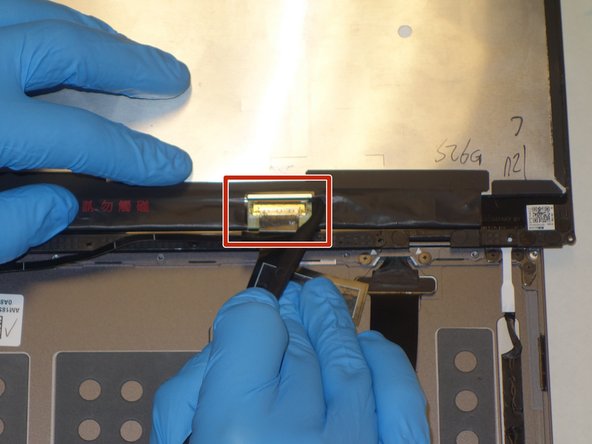

  • Use the halberd spudger to flip the metal latch of the display cable up.
  • Using the halberd spudger, gently pull the connector out of the display.
