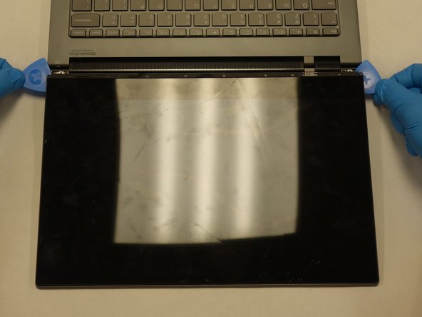

  • Gently wedge two opening picks underneath the display.
  • Slowly work the opening picks around the display.
  • Add opening picks as needed to keep display separated from the frame.
  • Use caution if dealing with broken glass.
  • The iFixit suction cup tool can be used to add some extra leverage to the mix when removing the display.
