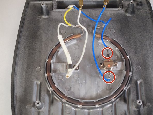

  • Remove the two Phillips #2 screws attaching the fuse to the grill.
  • Remove the fuse from the grill.
