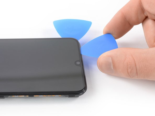

Separate the Top Edge Adhesive
  • Insert a fourth opening pick at the top left corner.
  • When nearing the front facing camera, only work with the tip of the opening pick to avoid damaging or smearing the camera. The speaker grill which is located above the front facing camera falls off easily. Avoid loosing it.
  • Slide the opening pick along the top edge of the phone to cut the adhesive. Leave the pick in the top right corner of the screen to prevent the adhesive from resealing.
