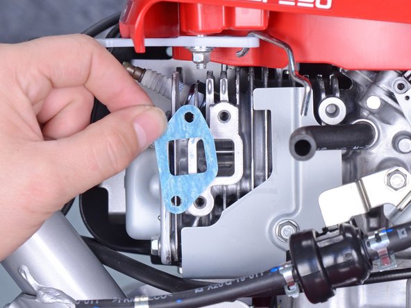

Honda Light Duty Tiller F220K1AT715492 Carburetor Replacement, Remove the insulator gasket: crwdns2935265:00crwdnd2935265:01crwdnd2935265:01crwdne2935265:0
  • Remove the insulator gasket 16212-ZM7-000.
  • This gasket can be replaced as part of the carburetor service kit.
