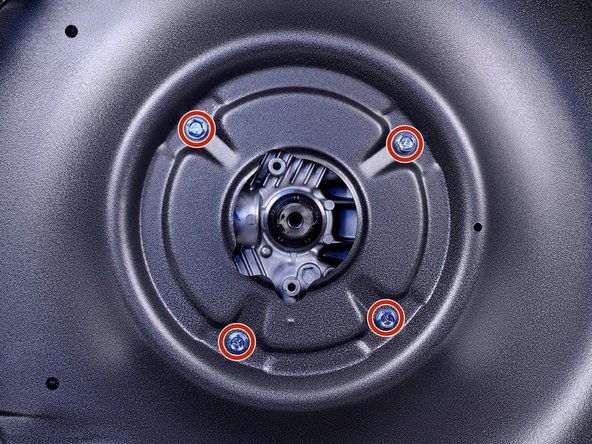

Honda Lawn Mower HRS216K6 PKAA Engine Removal, Remove the motor: crwdns2935265:00crwdnd2935265:01crwdnd2935265:01crwdne2935265:0
Remove the motor
  • Remove the four 12 mm bolts securing the motor to the frame.
  • Once these bolts are removed, the engine will be free to fall off the mower frame. If you are removing the bolts while the mower is on its side, you may need another person to steady the motor.
