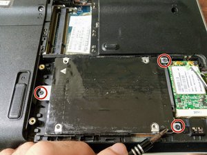

      crwdns2936071:01crwdne2936071:0 — Remove the lid that protects the hard drive
      Remove the 2 screws. These are holding the plastic lid
      crwdns2936071:02crwdne2936071:0
      Remove the three 5mm screws that hold the hard drive in place
