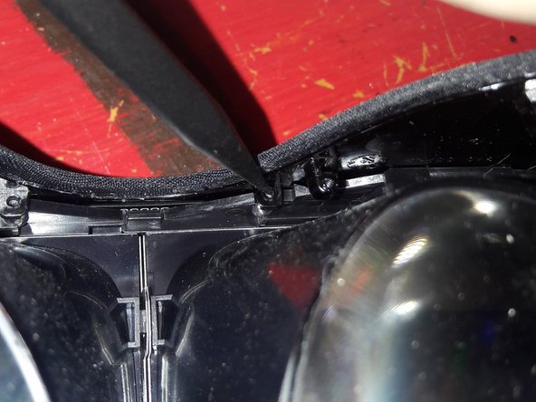

Release three additional tiny screws
  • There are at least two tiny screws that are holding the electronic frame to the google. You can see them on pictures 1 and 2.
  • And another one that is holding the lens button you will need to remove in the next step. You can see it on picture 3
  • I used T3 torx screwdriver to release them.
