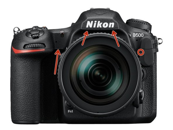

Nikon D500 Top Panel Removal, Remove Front Screws: crwdns2935265:00crwdnd2935265:01crwdnd2935265:01crwdne2935265:0
Remove Front Screws
  • Remove the screw under the top assembly, had been hidden by the grip.
  • Remove the 2 screws from the bottom of the mirror box
  • Remove the lens or lenscap prior to doing this step to gain access, then reattach.
  • Remove the screw from beside the accessory socket
