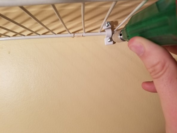

  • Use a Phillips screw driver to screw the c-clamps into the plastic anchors and reinforce the rack.
  • Use Phillips #8 1-1/4" screws for best results.
