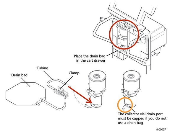

  • Check to see if your ventilator uses a dran bag.
  • If your ventilator uses a drain bag, attach the drain bag to the collector vial as shown, which is placed underneath the expiratory filter system.
  • If a drain bag is not used, make sure to cap the bottom outlet of the collector vial.
  • This step is crucial as it allows the user to proceed with an expiratory filter test described in the conclusion. Ensure that the drain bag, if applicable, is attached fully.
