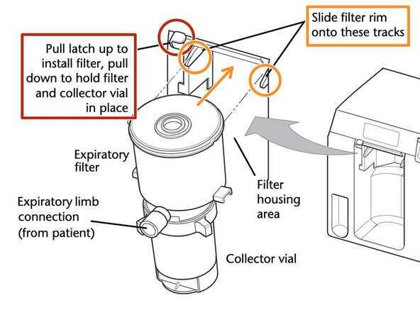

  • Locate the same latch used in Step 1, and lift it up gently.
  • Slide the new expiratory filter system into the housing so that the rims rest on the ridges inside the housing.
  • Ensure that the fitting for the expiratory limb tubing is facing your direction before sliding it in.
